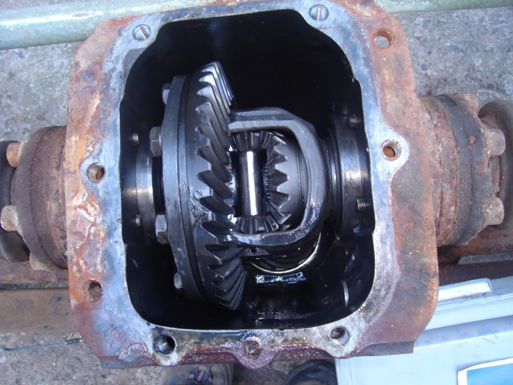

Ja keevitada saab nii:
Tavalise diffri sisu:
http://i200.photobucket.com/albums/aa91 ... on2001.jpg" onclick="window.open(this.href);return false;

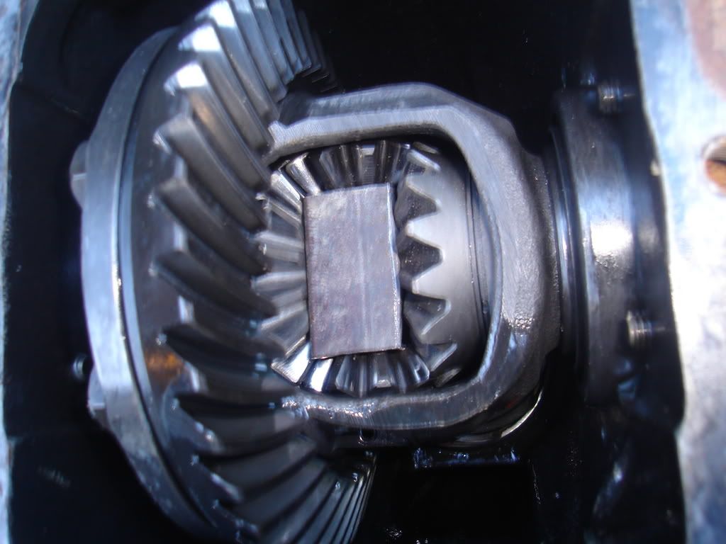

Mõned tükid mida saab sateliitide vahele panna:
http://i200.photobucket.com/albums/aa91 ... on2002.jpg" onclick="window.open(this.href);return false;
Panna nii sisse:
http://i200.photobucket.com/albums/aa91 ... on2003.jpg" onclick="window.open(this.href);return false;
Ja korralikult kinni säristada:
http://i200.photobucket.com/albums/aa91 ... on2005.jpg" onclick="window.open(this.href);return false;
Panna nii sisse:
